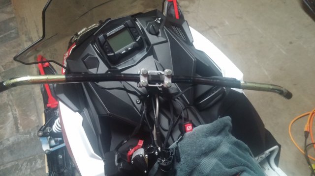

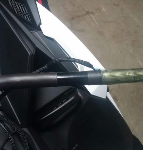

No heating element out where my pinky finger rides.

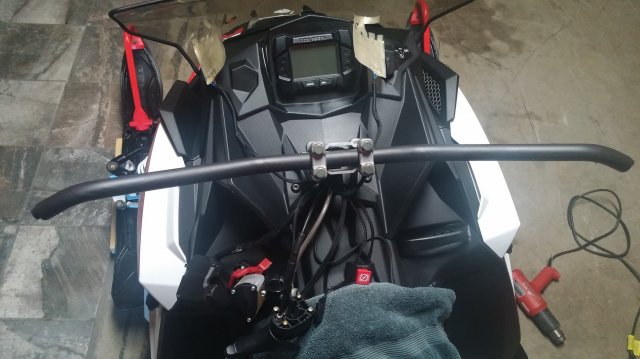

I pulled off the heaters and put 25mm heat shrink over the entire handle bar.
I had to remove a section of heat shrink where throttle goes. Put heaters on top of heat shrink. Rode 4 hours at -10F today. Riding on trails I ran heaters on low today. Much improved. Same general idea as the cork but a little cheaper. One meter of 25mm heat shrink was 5 bucks.
