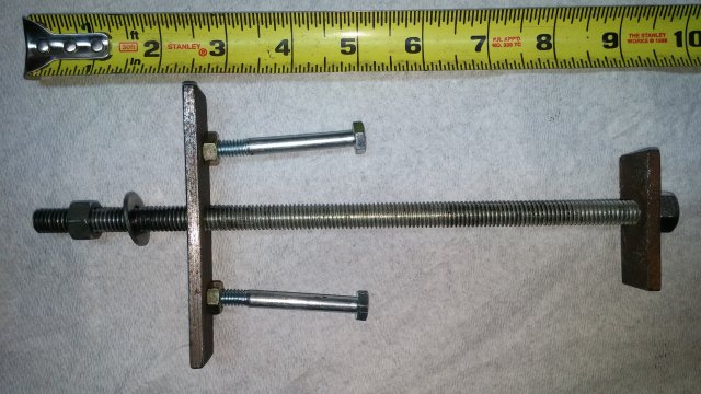

Going to be 36 f today. Switched to 155 - 222 spring secondary spring. Easy to change spring when you make one of these.

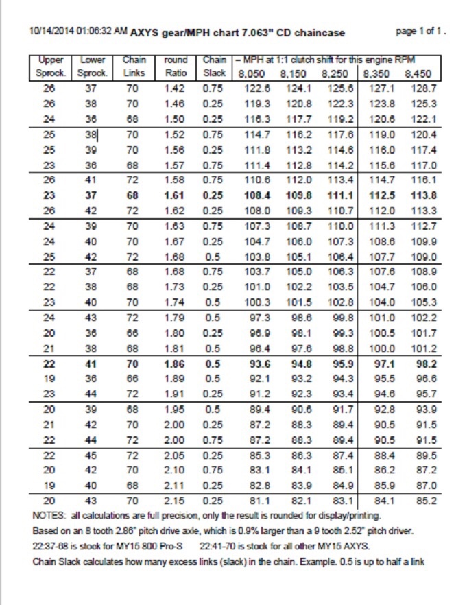

So ur using a 1.66 gear ratio correct? I don't recall seeing that in polaris' recommended gearing chart in the axys reference sticky. I didn't think u could use ratios that weren't recommended by factory?
I'm curious how ur clutching setup will work with 1.81 gears, as ur clutch setup is very similar to the one I wanna try
Sent from my SM-G360T1 using Tapatalk
From the chart you can see I'm used 1.67 gears for test 4 and 5. The 1.74 may be quicker in some conditions. Interestingly, the stock 1.61 gears are about 6 mph faster breaking trail on the lake in deep powder than the 1.67 I'm running now. But I've settled on the 1.67, specifically for the 40 tooth bottom gear.
I choose to change springs in secondary to compensate for outside temps. In warm weather I use the team black 155-222 spring. In cold weather I use the stock blue black 123-203 spring.
My rpms are almost always between 8200-8300 by changing springs, except for extreme temps. For example, today it was 45 F out and I was pulling 8100 with the 155-222. Ten days ago it was -5 F out and I was pulling 8400 with the 123-203.
I've never changed driven springs before to keep up with conditions. This is new to me. Previously I always changed primary weight. I don't have an answer why my sled ALWAYS pulls 70 gram EPI's so consistently with only that spring change. But it's working for me and that's what tuning is all about.
Thanks for postin Ry3an7, I haven't seen that chart I guess.
As for the bit Ru4real posted about the 1.61 breaking trail faster than his 1.67 in deeper conditions, does anyone have a theory as to why? Is it because of the way the clutch is setup? Common sense would tell u the slightly lower gear would have the edge in those conditions, all else equal right?
The 1.61 may have seemed faster and a speedo reading doesn't tell the 100% truth or seat of the pants.
Timers tell what's really going on and we use them. Only way to be 100% accurate and pass on good info .
Set a distance like we do. Let's say 1/4 mile to be fair to the 1.61 ratio. Set timing system to mark , 60'. 100',500', 660', and 1/4 mile You'd be surprised what gear ratios work the best. And it's never the 1.61 at any of the distances I mentioned. Slowest at every mark in et and mph. We've tried it in 2015

There is a reason Polaris only used the 1.61 ratio for one year and changed to a lower one. Huge inconsistencies cvt system.

You're going to find the 1.74 Ratio to be the best all around setup.
Stock ratio in the Assault.
