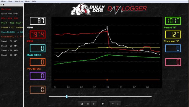

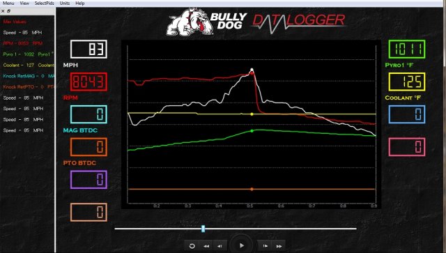

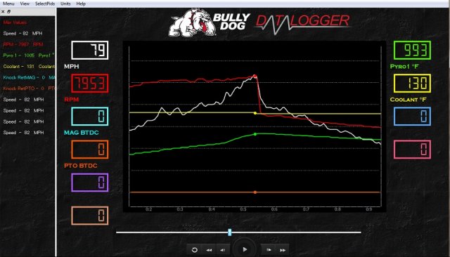

I am not much of a tuner but last weekend I got my Butt handed to me by a etec 800 bad. And my buddies cat 800 was only a sled length behind. My sled does not rev out like it should. I had a SSI pipe mod and it would rev out but had bad DET issues so I got a Bikeman pipe. It does not rev out unless I have a long run.

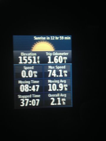

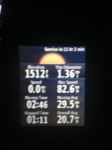

I did 3 runs. I did data logs with the bullydog, and got GPS speed with a garmin. My test track wasn't the longest or best conditions but it is what I had to work with.
1st run
Setup as it was for baseline
2nd run
flipped helix from 50-44 to 48-44
3rd run
reflashed bullydog with hotter tune
Figured I would post this some of you might find it interesting or have some advice. I'm not an expert but I believe I'm not reving out enough at only about 8000 rpm at 85 mph and my pipe temp is only 1000 F? I'm thinking I need to remove some magnets from my weights or try some less aggressive weights
