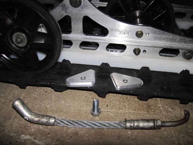

    Has anyone fabricated any scratchers for the axys yet? If so could you post some pics of them and some info of where to mount and cost, thanks guys.

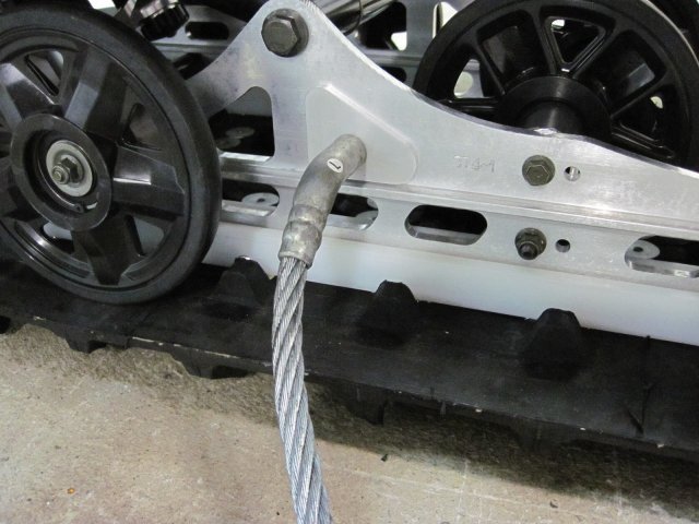

    I have some plates that fit into a window on the slides. They are made by a member of HCS. I can pm you his info if you want, or go there and look for the thread on the AXYS board. axdura1.JPG axdura2.JPG

    Thanks Dave I would appreciate if you pm me his info. That's what I was looking for, no drilling. So how did you get the plates to stay? What's the chances of them coming out?

    There are actually 4 plates. They sandwich the rail. One on outside on on inside. I will use Dura Flex scratchers. Check your message here.
