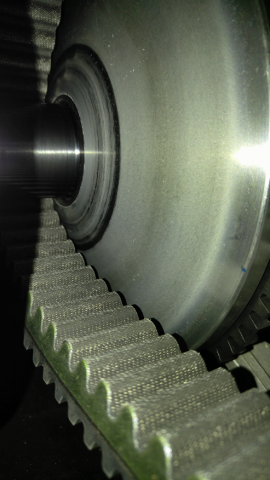

Picture of my primary. Is this what everyone is talking about with smearing?

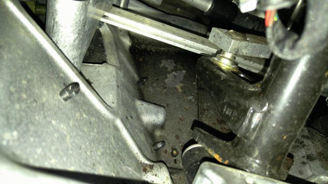

I know the sled has been sitting but I’m wondering if you think this is a good reason to check the Y pipe?

That is definitely the belt smearing people are talking about. Also you can tell that it has not been shifting out all the way the belt doesn't go all the way to the top of the clutch. Clean it off with a scotch bright pad

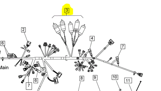

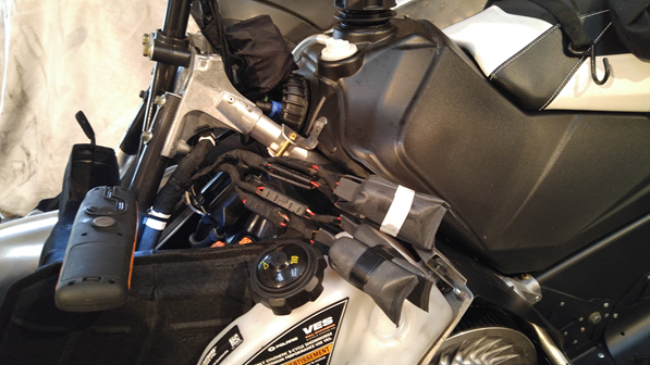

The 2017's have new capacitor setup not sure if you can update to the new design or not maybe you can look into it?

I can see you need to torque your y pipe as its leaking. Seen a few of these and not being perfectly flat either. But the 0.070" thick gasket usually makes up for that. Polaris doesn't use loctite on these. I use blue loctite.
Your belt needs a scuff on the sides to grab as I can see it's probably slipping up top. Use purple scotch brite pads on belt and clutch sheaves.

Ditching the belt in the photo and running gates. Will check the Y pipe too.
I think I'm going with the stock capacitors, but $90 each is a bit steep.
