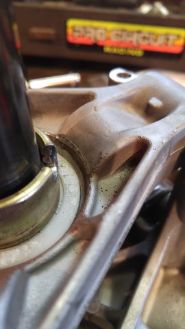

Onto looking at reasons the Gates belts were blowing so quickly before the next trip which will be a short one and more of a test for the Polaris belt to see if it holds up. I looked at the sheaves and they are in perfect shape. I measured the last Gates belt I have and it's the same as the Polaris. Put a mark on the edge and rolled it along the work bench. About the only thing I noticed is the primary sping was hitting the spider. Is this normal? Also it doesn't sit flat like the stock spring.

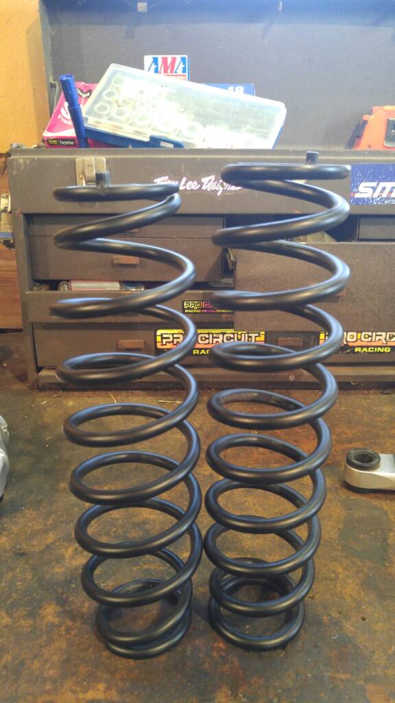

Just discovered I have one pro-s and one pro-x spring from the factory in the front. Talking to dealer to get it replaced.
Tapatalk blackmamba
Good find on the front springs. How the heck did poo miss that one?

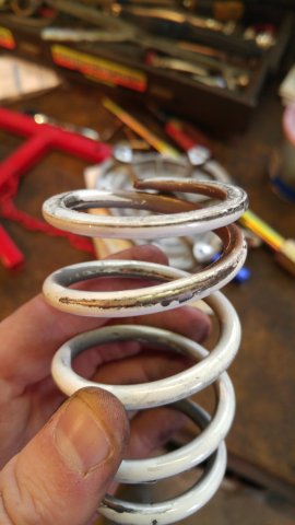

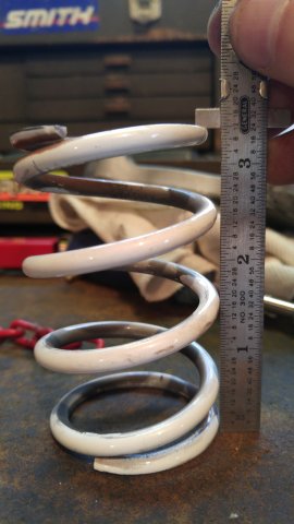

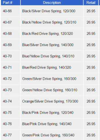

I looked at SLP and they have a replacement for the 120-310 but I don't see anything less than 120 start rate. They are cheaper than Polaris. I'd like to try a spring with a little less engagement and order both the 120-310 and lower rate from the same place. If not I guess it's not big deal. When I look at Polaris' website they have the 120-310 and a 110-290 but the 110-290 says for non electric start.
I thought all of the springs would be the same length but when looking at the service manual they seem to vary. Could this be the reason the 110-290 is for non electric start or is Polaris mistaken?
Not really sure what rates I should look for if I'm going lower.

The Polaris 110/290 spring will work in your clutch with electric start. The length and wire diameter is how they get different lbs and rate springs.
