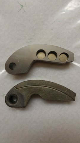

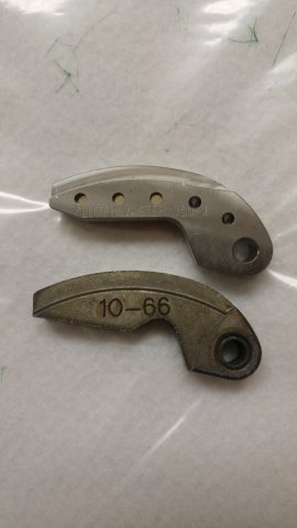

Do indy dans weights have a bushing in them? On his website it looked like no, but wasn't sure what stage of production the picture was taken.

They do not have bushings.

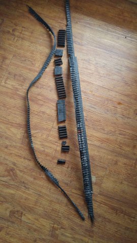

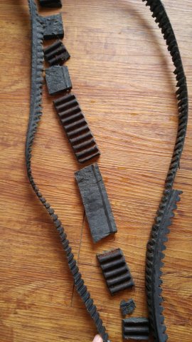

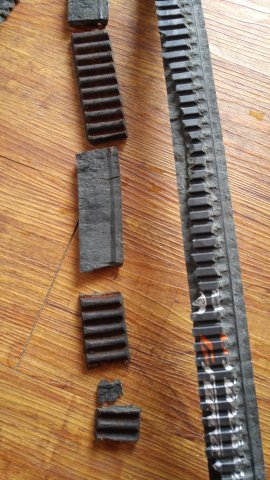

I was able to keep my hands on the clutches but they were pretty warm. The first belt the outside layer stayed together but inside of the cord it split. The pictures are of the second belt that exploded as I was doing hard pulls on the lake.

Pats said the alignment and float is perfect. They recommend polaris belts over gates and said I probably got on the throttle too hard before the belt warmed up and created a burn spot. As that spot went around the sheaves it beat up the belt causing it to seperate. So far 70 miles on the new gates belt. We'll see what happens.
