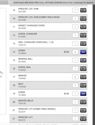

Just to confirm ... and if anyone is trying to figure this out ... if the sled has a Cobra track it's a 1.68 (22/37), and if it has a Rip2 track it's a 1.61 (23/37). This is per the online parts for the Pro-S
Thats for 2015 model year. They changed it for 2016. Standard model ripsaw RUSH 800 PRO S 2016 is 1.78 (23/41). LE with cobra track is 1.68 (22/37)
