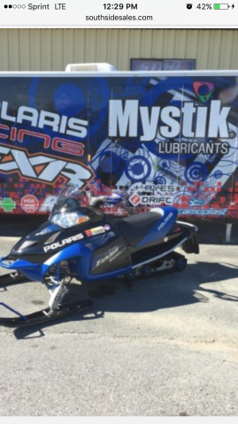

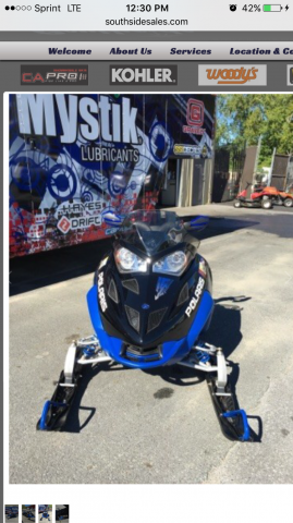

hey guys looking at a sled for my wife. Not looking to break the bank here. I can get a 06 600 fusion, studded, 4600 miles for $2650, any thoughts here would be much appreciated. She has only ridden 550 fans. I know the 900's were trash but looking for whatever input on this 600 fuse.

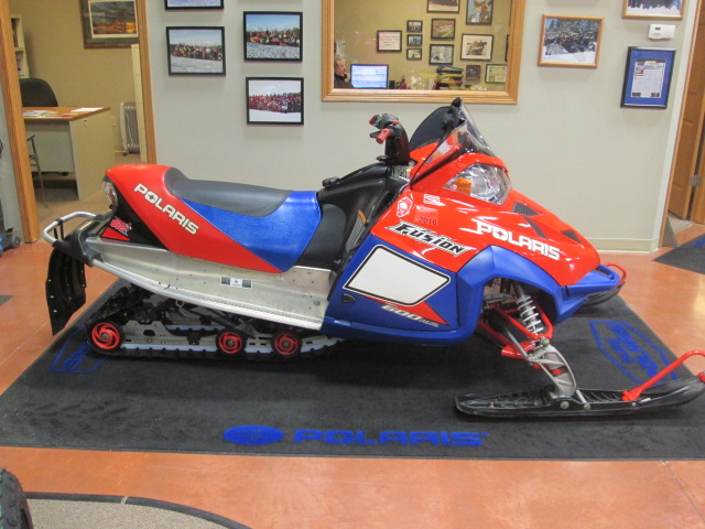

I had 2 of them. First of Polaris rider forward sleds. Very similar to today's Indy except seating is a little lower, But much better than the Edge ever was for me. One of Polaris best trail sleds. Heavy steering is subjective IMO, I would let her ride it first. Be sure to look over the carb intake manifold's. They crack and delaminate very easy. New ones are a good piece of mind. Stock clutching is fine for someone coming from 550fan. There is a little more if you want to spend a few bucks. I would check to see if the timing was bumped up to 28 degree's. Thats 2 degrees over stock and made 90% of them run much better. The best improvement you can do to a Fuse600 is the timing bump. $2650 is in the ballpark based on condition. Any pics? What else can you tell us about it? This was my last one.

I don't have much input from from it he had 2 black n blue fusions that he traded in. He lived in New York. It's a 3 hour ride for me to go and look at it. I just wanted the skinny on the fuse and about a 2 spot trailer. I will ask dealer how the manifolds look and see if he knows about the timing being advanced.
