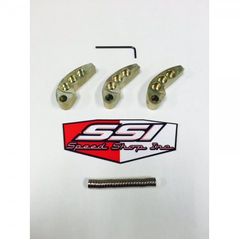

I am leary of magnetic weights, for fear of the magnet flying out, but they are becoming popular. Opinions on these SSI weights? Price is reasonable at $124. Is the magnet close enough to the heel end and the tip end?
I have heard guys say as far as the Dalton/Cutler setscrew adjustables that you can't get enough weight on the heal end.

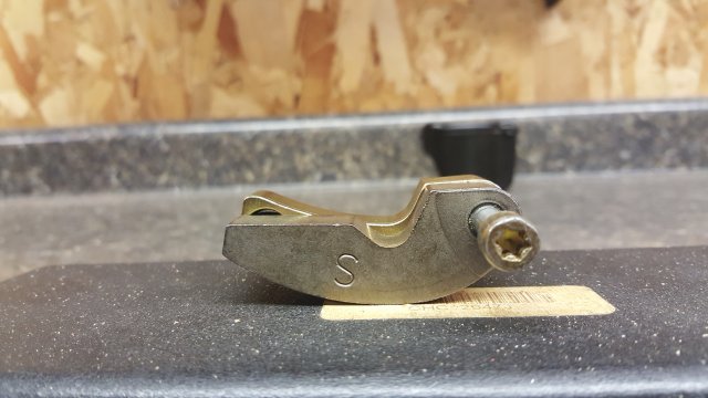

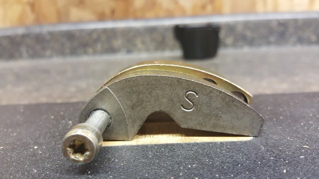

I'm interested in those too. I'll have to call Erich on what the profile curve is like though??
Looks very 10ish,but looks are deceiving. Also looks like the tip weight is more end of mid tip.
they are the same as BMPs ill try and get a pic of a 10- and these side by side ..........
Heath do you think the weight hole is close enough to the heel end and to the tip?
On the heal ,yes . I would like to see the tip adjustment further out myself, but it is what it is... Lol what I want to know is how many magnets does it take per hole to get the weight back to where it was before it was machined . This way you will know how much added weight ur installing at each spot. Extra I mean

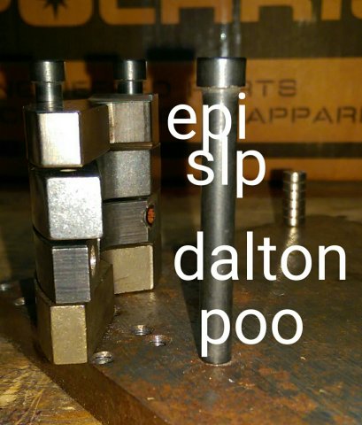

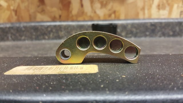

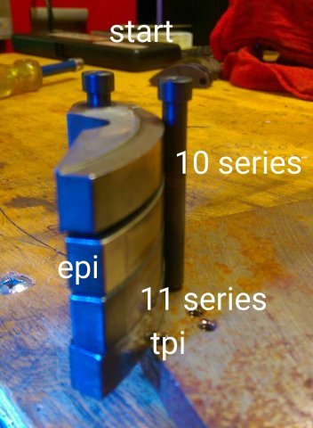

In your second and 3rd pic, you can't go by the tip resting on something. Has to be the heel in a Polaris clutch. The end looks pretty thin on top.
Yes that's why I took multiple pictures.
I agree with rd.
Nice pics, but the tip can't be resting on a table like that to see the actual profile.

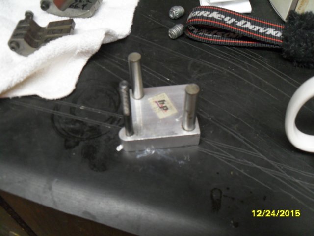

You need a jig so a bolt can exactly be were pin placement is on clutch(duplicated) from the start.
