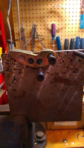

I just received a set of pro mag weights from Erich at ssi.
I like the ease of adjustability, but the heels are tucked 0.040"+/- 0.003" vs the 10 series.
That's seems to much to me and will engage about 500 rpm higher then stock 10 series weights.
The 10 series weight is in the back ground.
You can see how much the ssi weights are tucked vs 10 series.
By the way, my jig duplicates exact pin placement in clutch for verification.
That's seems to much to me and will engage about 500 rpm higher then stock 10 series weights. Also, belt to sheave has to be readjusted.
