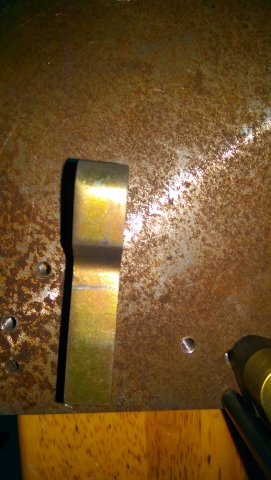

I posted this before,but.....
This is an ssi pro mag adjustable weight. It's tucked to much the weight hits the webbing in clutch before it sits on heal. Just slightly, but enough to leave a mark on weights. Tucked to much to fit cat clutches too. I told Erich about this. Hope they revise their weights.
Meanwhile those who purchased these weights are stuck with them?
They seem to work fine to me? What will happen if I keep running them the way they are? Another ssi product that doesn't work right
Nothing Cory,it's just your limited to springs you can use because it's tucked ( engages to hi). I myself don't like that and like to use different primary springs.
The bushings in them suck though. They can be replaced though.
great explanation minus40,as i was reading this i was thinking the only way the belt to sheve would not change because there is no roller pressure on weights.that spacer is stepped,i use this concept on my water drag sled primary,which is a cat primary. to change out weight and not worry about belt spacing.
How do you fix the untuckness? Just grind the not tom of the weight right there so it doesn't hit?
