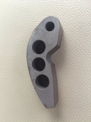

Interesting that holes are on the positive side of rotation vs others
These are a more aggressive profile so the weight is a bit taller at the roller contact point. I've made them with the magnet holes on either side of the rotation and never have lost a magnet.
yes, these are a cutler profile but was not able to test them .
will do i'll have a few other profiles to try this fall. I've always had the best results from aggressive profile -lots of mass early in the weight then a bit lighter towards the tip , grabs the belt hard out of the gate and shifts hard but also backshifts better but this is my first experience with the roller secondary so it will be a learning experience. Also most of my riding is flatland with not a ton of snow but good traction and no more than 1000ft simply because we have no place to run that far.
The profile was copied off the mag weights

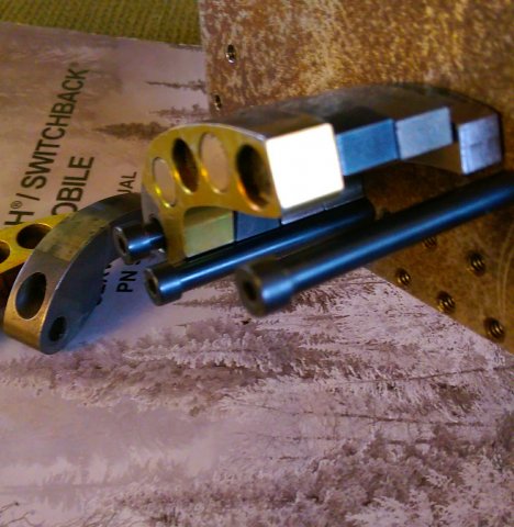

Shows the different profiles when sitting on clutch roller(duplicated)
Old epi weight on bottom, 10 series second from bottom, Dalton third from bottom, gold stars at top.
Shows how aggressive the old epi is vs the conservative gold stars.

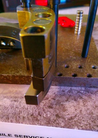

Same as above pic, more aggressive on right to least aggressive on left.

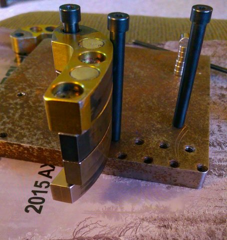

Old epi on bottom,heavy hitter,ssi and gold star on top.
