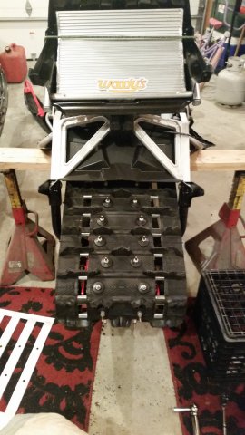

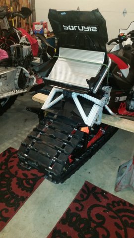

When you go to stud it It's pretty easy if you remove the 4 bumper bolts and tip it up. Hold it with a strap. Just make sure sure you get the plastic panels back correctly or the studs with catch it and make a hell of a noise!
