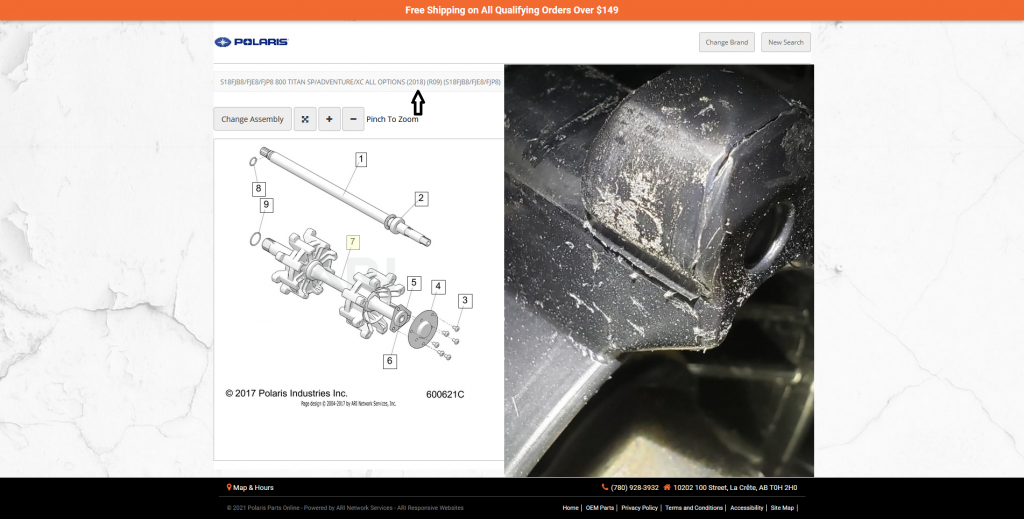

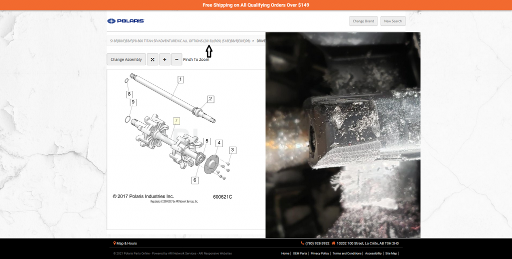

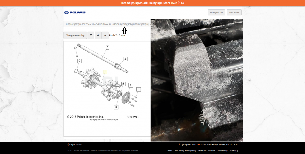

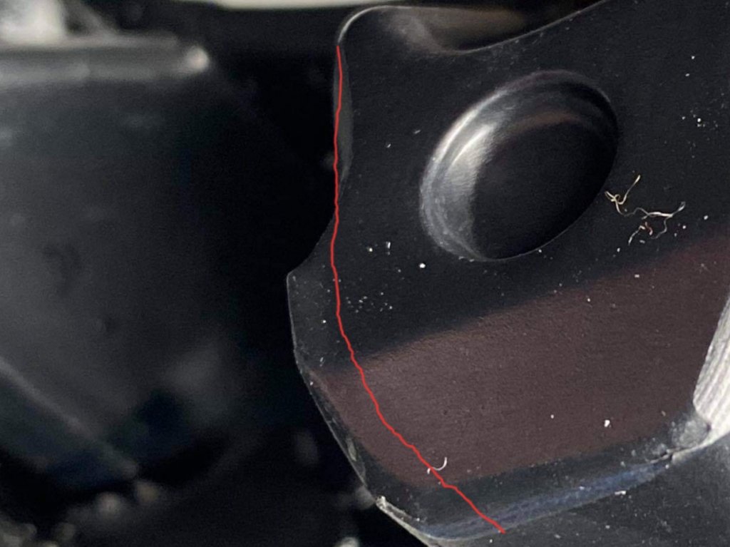

Has anyone else had luck reshaping the drivers? Any issues as a result? I'm interested in reducing track noise as well. I might see if a shop in town could do Stan's mod for me as it's beyond my skillset.
This is the issue, the track is different so reshaping seems to be the best bet before replacing it all. The track on pre 21 titans is compatible with skandic and Yamaha vk's so it's not worthless but a costly upgrade.I’m thinking that if the new axle, drivers and bearings will work with my existing track that it maybe worth trying as the driver reshaping seems to really help and the bearing change for 2021 looks significant. Don’t get me wrong as I’m not happy that Polaris is leaving us in a lurch but figure it will be way less expensive than trading. Anyone know if we’re okay with the existing track and even maybe port it as well.
I’m thinking that with the new bearing design the item “ 5 “ bolt is there to keep the axle/drivers centred re the track windows. I say this as when my machine is run on the track stand the axle/drivers become centred at higher speed and the vibration goes away.
