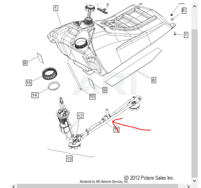

That sounds high. Has the fuel pickup in the tank ever been replaced? They get plugged over time and need to be replaced, usually you can hear the pump whining when this happens..

In your case, I'd question the fuel pickup still, there's an inline filter on those that could be getting plugged. Sounds like the pump solved a few voltage issues on that post, but those guys were running AV gas for turbos which killed the pump itself. Thats why I'm thinking pickup in your case.

Oh, IC. by the fuel pickup you mean fuel pump right, here is Canada we don't say pickup, pickup is a truck...lol
By pickup, I mean the assembly that sucks the gas from the bottom of the tank, not the fuel pump itself. See the arrow below.
The part I'm pointing at is an inline metal filter in the assembly, most likely plugged.
SPI makes an aftermarket version of this.
