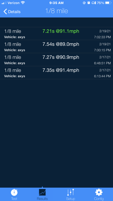

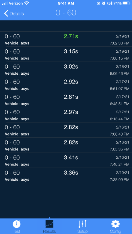

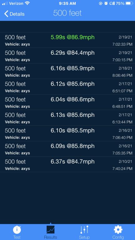

Did some quick testing this afternoon with my Gtech and here’s my results
60’ - 1.77s 43.00 mph
660’ - 7.238s 94.30 mph
1000’ - 9.642s 100.10 mph

Looks to be running very good! I plan on upgrading to a 129" 850 this summer. Have you ran against any 137 or 144? I wonder how the 3 track lengths compare with everything else being equal?
I haven’t ran against other sleds yet. Mine is a 137” VR1 850 with 1.5 Storm track. My new one definitely pulls better than my 129” 850. It launches way better.
From post I have seen... the 144 tops ends the best over the 129 and 137. I would guess the 146 is slower then the 144... the 2.52 pitch are faster then the 2.86.
Could also be approach angle or other angles from wheels that tracks go over
