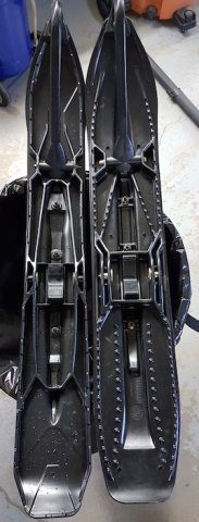

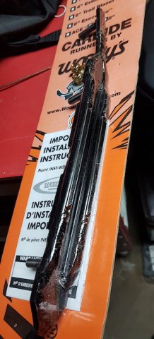

Decided to try the Dual carbides on the grippers. Trying the 4" carbides

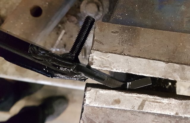

You have to stick the rear in a vise and straighten it a bit. its to curved for this ski

Decided to put grippers on. Here a lot of good things about them. Saw a bunch of assaults on the trail last weekend. they all had grippers on. Said they were really good.

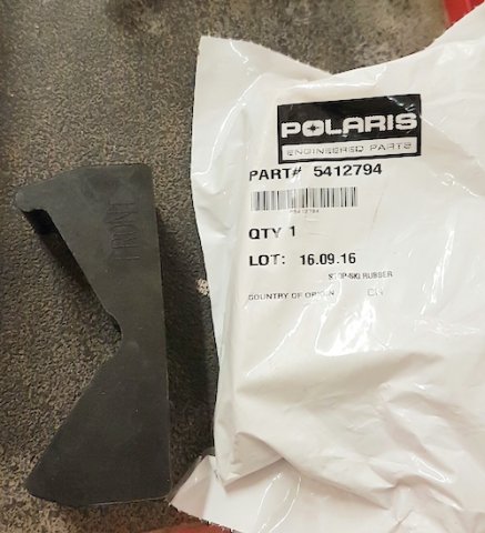

You need different rubbers then the stock pro steers. Pretty cheap. At least you dont have to buy mounts like other ski brands.

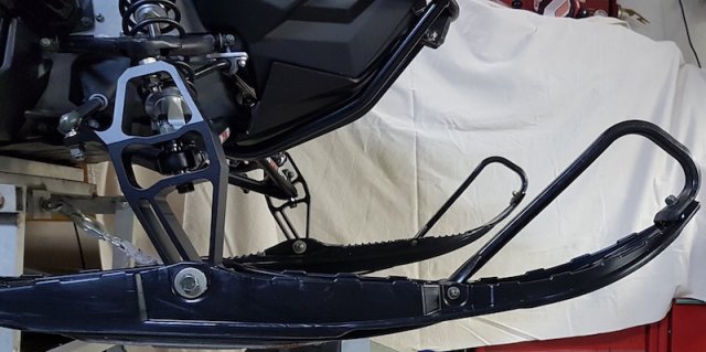

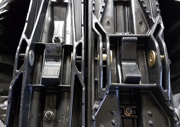

As you can see in the pic the gripper sits better and up.
The stock pro steers bend forward and is part of the cause of wearing the front of ski out

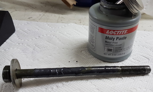

I use molly paste on the bolts and bushings. Its the best for preventing wear on metal parts. This stuff is not cheap but will last you a long time and is the best you can get. Its good for using on splines as well.
the cheap grease you see at the parts store says molly grease but it barely has any molly in it. Has some molly in it so they call it molly grease.
