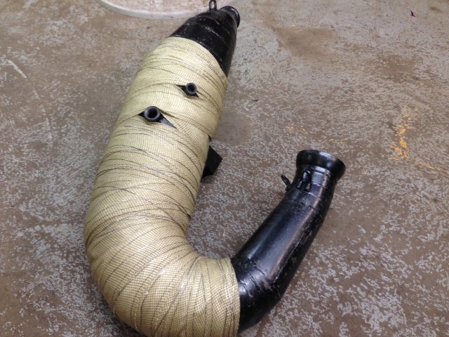

I buy i jaw pipe last month and I want to know what is the best method to wrap it . Full warp or partially like this pic ?
ha ha ,that's my picture,and yes just like that or buy his heat shields. You have to remember,if you wrap it you need to take better care of it .When the wrap gets wet and sits it will hold moisture and rott,and you don't want that, cant leave the sled out in the rain, crap like that..
Yes it 's your pic !! But when the pipe is hot the humidity must come out of the warp ?
lol, I mean when a sled is left out side ,or neglected..lol the pipe will rot, had it happen to a buddy on that exact pipe ,took it to the dealer for service and it sat outside and fucked it up

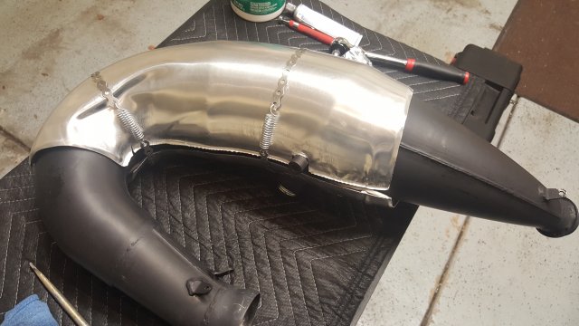

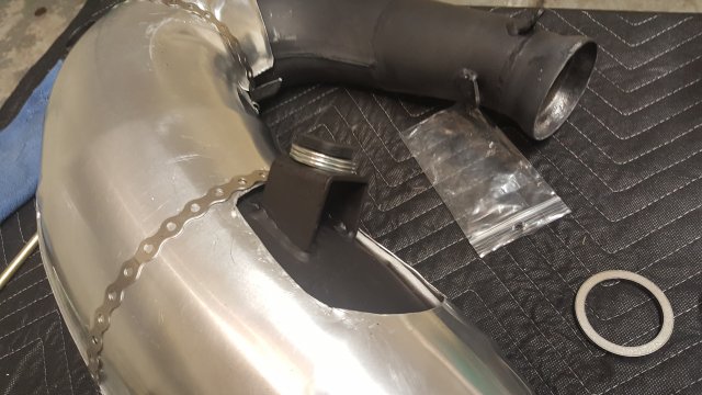

Looks like my kids made those heat shields.
Personally, I'd be pissed if I received something like that for $150.
Shipping is shipping, but that seems high too.
I know diesel and stamping costs money, but there's only about $5 worth of material. Maybe $10 at most.
I'd be reluctant to put it on my sled.
Hopefully it functions better than it looks.
I think Brock has the right idea with the wrap.
After all, it's a very thin layer of insulation under the aluminum, and of course the aluminum itself has zero insulation factor. In fact, probably works as a heat dissipator.

I don't mind gregs heat sheald? It doesn't fit perfect but does the job . I realize it can be finessed better.
Greg's shield is overpriced for sure when compared to the quality. But, I will atest....it does its job.

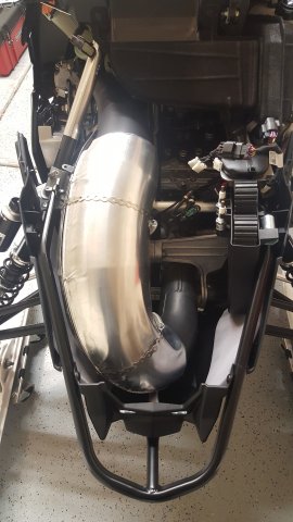

Certainly looks better installed on the pipe, and looks like he polished it up a bit too.
