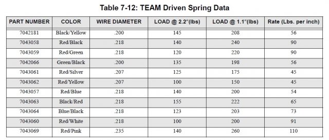

any one know what size the secondary spring is when they say its blue/black. my team chart doesn't show that color combo

I know I said a 50/44 fp many times. That might be a little much for the heavier guys. Go with a 48/44 fp like doc said or a 48/42 fp. Use at least a 120 start secondary spring, I like the 140 start. It holds tension at start from heavier primary weights so the belt don't suck down in primary when u nail it. I like the 140/220 secondary spring.

Ditto. IMO it will come down to one of five secondary springs: 140-200, 155-222, 123-203, 140-220, 160-240. The mid 50 to mid 70 spring rates work very well with the cfi's. Select the starting poundage for good take off with your sleds ability to hook up.

Ya im confused here to. I thought the 155-222 would be stiffer then my 140-200. I think 8m using to soft of a spring in my team tied and my belts dropping down to fast
I think my problem is im using to soft of a spring with alll the studs im using so its sucking it down to fast????

OK. A 160/260,160/280 180/260 are to stiff to me. Normal to me are, 120/200,120/220,140/200,140/220,
140/240,123/203. I consider a 140/240 the stiffest spring I would ever use. Just me.
Stiffer gives better back shift buts hurts up shift . Stiffer springs cause more friction,heat,belt heat, and that all can equal rpm loss and hp to track.

Brock the 155/222 must fall in your usable range then?
