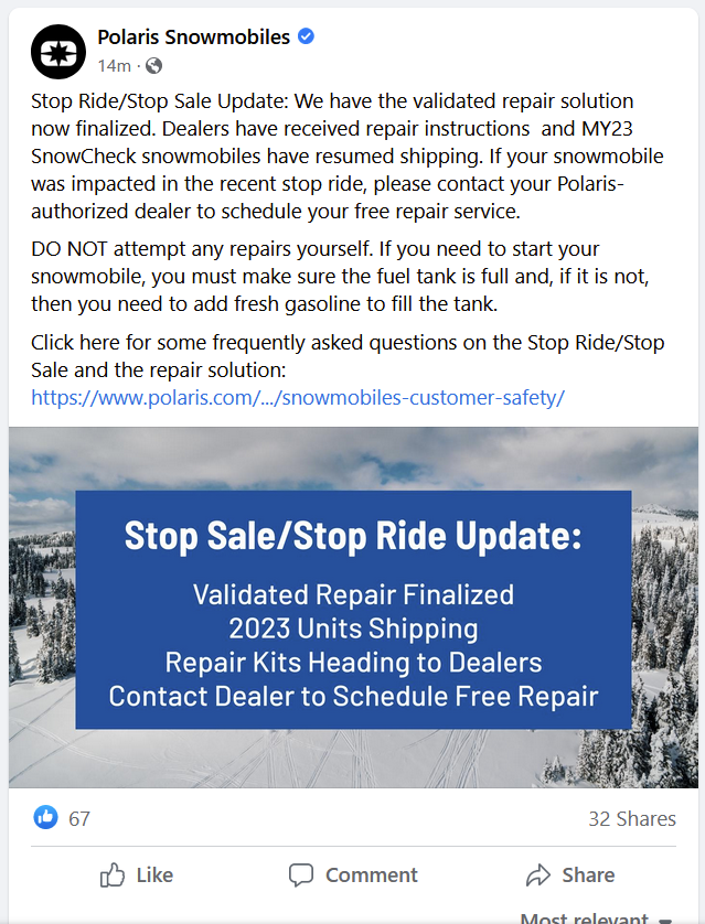

Suppose to be an official update coming from Polaris sometime this afternoon....
I just talked to the dealer that I purchased my machine from and (they claim) Polaris told them not to expect parts for the "fix" until sometime in December.
Talked to Power Lodge today, they say they will have parts in hand by the end of October and start installing immediately thereafter. They are taking names for a waiting list, first come first serv. Hope they have better information the first dealer I talked to.
The word (from a dealer) today is "dealers will have parts sometime in December". So I called Polaris customer service to see if they have any answers, customer service says "we are, and have been, shipping parts to all the dealers for the past 2 weeks". Maybe uninformed dealer? Anybody else hear anything?
I've heard that the repair kits are trickling in slowly, also right now they can only order parts for VIN's that they sold ( or have in stock) at their dealership. They need a VIN to get a kit and there is a whole documentation process (photos, etc)that must be submitted to Polaris.
Supposedly after Dec 1 they can get parts for any machine. Sounds like they are buying time to get an ample supply of kits together.
