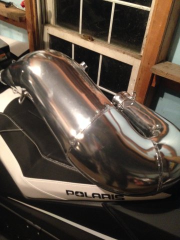

It's my opinion that the stinger outlet on the SSI pipemod is on the tight side. It seems your sled is having more problems than most. I would recommend looking up the stinger outlet (camera) and checking to make sure there isn't a bend in the internal stinger, some welding slag and/or etc.
Also I would consider keeping the PCV with timing, it's a pretty good piece of equipment.
Just for reference, the SSI stinger is made of 3 pieces (straight then a bend followed by a shorter straight piece).
I've compared my Dynojet software to the Digital wrench software and the numbers aren't the same. If I used the DJ software to check full throttle I would get lots of high TPS readings. Put it on the DW and it's well within the wide open spec. Not sure what anybody else has seen but that's how it plays out on my PC
Yes I am also having that issue my pcv. full throttle tps is correct on digital wrench but pcv is high when I sync it. So how do you set the calibration in the PCV? That's one of the reason I wanted to get rid of it I don't think the maps are aligning correctly? And the temp setting does not read right on pcv which isn't a big deal just shows it is not working well with the sled
Yes, there is a welded bend inside the pipe. (Which I wonder how much more back pressure that creates compared to having a rounded bend. The BMP is slightly wider, shorter and doesn't have the bend.) What I was meaning to check and see if there is a dent (in the tubing), weld bead, weld slag and or etc. inside the internal stinger outlet that could be causing additional resistance.
I was looking at modding stock pipes earlier this winter.
The end of the pipe itself turns down towards the silencer. I believe the are trying to get the stinger to line better up with the main body of the pipe. Look up from the end of the pipe and double check one of these pieces is not broke off inside the pipe.
