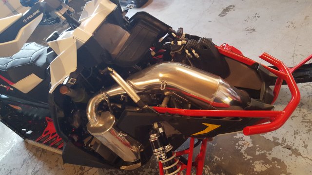

Ya I have the bikeman full pipe and SLP can on

If we get any snow in maine ill let you know how a 50-44f works. My buddy stayed stock gear so we can compare. I didn't do a pipe or can as I spent a bunch already plus I don't want the added noise level
