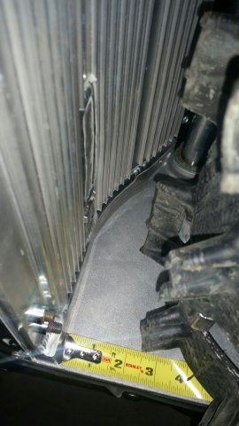

But , just want to be sure they work before I order them or is there something better ??? Looks like something can be inserted right down the heat exchange groves
Had one guy drill his and said it made no difference in temps. I also know of at least two guys running the 1.450 studs in the center and not adding the tunnel protectors. Both have several hundred miles on their sleds.
I looks like they should work there is over a inch of space past the heat exchanges not sure if further protection is needed
I'm running 1.86 with a 1.75 track two down the center and no extra protection. No issues.
What size studs do you have in that track and how many miles have you put on that set up without any tunnel damage?
They are 1.86" tall, track has 300 miles on it and no issues so far. There is a few inches between top of track and the tunnel. I run the track a bit tight, 1/2" slack when track is relaxed.

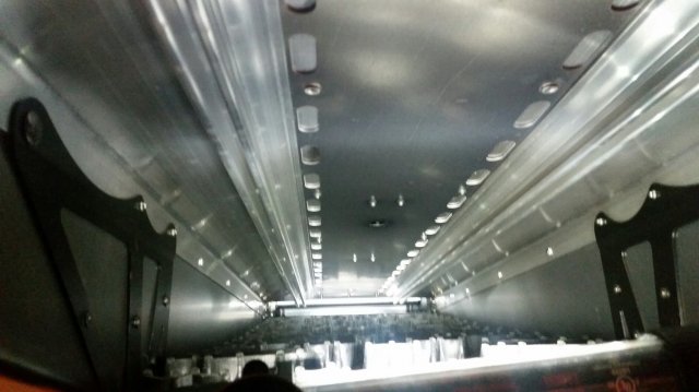

The protectors I installed are from Polaris. They are about 6 inches longer than the rail in the tunnel that they mount on.is this right? They do go all the way down the actual heat exchanger in tunnel but the last six inches are not hooked to the tunnel due to the mounting rail don't run the whole length of the tunnel 2019 assault
I'm not adding any extra. Have the Cobra track and using Woody's 1.450" in the center only. Looks like plenty of clearance. The track lugs will hit the protectors that are on the coolers before the studs hit the tunnel.
View attachment 1419 question , my 2013 assault doesnt have them aluminum rails on it
