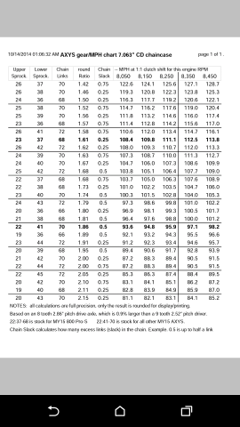

what is "over drive"? So 1.74 is 102 MPH at 8250 rpm at 1:1 ratio. Seems like that would be pretty low for these sleds that get to 100 pretty quick and some guys are hitting 116 on the speedo? Where stock gearing is 110 at 8250. Not saying your wrong just trying to understand how gearing for 102 mph (1.74) would be a good idea? Here is a gear chart I found
Your correct my friend.
8250 rpm = 102 mph @ 1:1 ratio.
Times this by 10% let's say as this is achievable.
102x 10%= 10.2, add this 10.2 + 102= 112.2 mph now . You'll know you got this when you do a marker test on primary and it's all wiped off.
You got me convinced I think I understand. I don't think I need any more speed then that and lower gearing will make sure i get there
