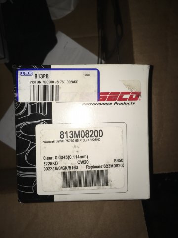

82mm pistons with 20 mm pin?????????????
So you're putting in 82mm pistons vs the stock 85mm pistons???
What am I not getting here?
A problem that is plaguing the HO motor ....The transfers are to small, smaller bore will correct some of that....have you ever heard of Advanced Sleave?
I have
All 800 motors are plagued with flaws.
You have the luxury of making bore smaller because of you're longer stroke. More or less like a doo bore n stroke then?
Personally, I'd be working on getting rid of half of the positive piston clearance on the stroker and keeping same 85mm bore. Projects are awesome though Div20
