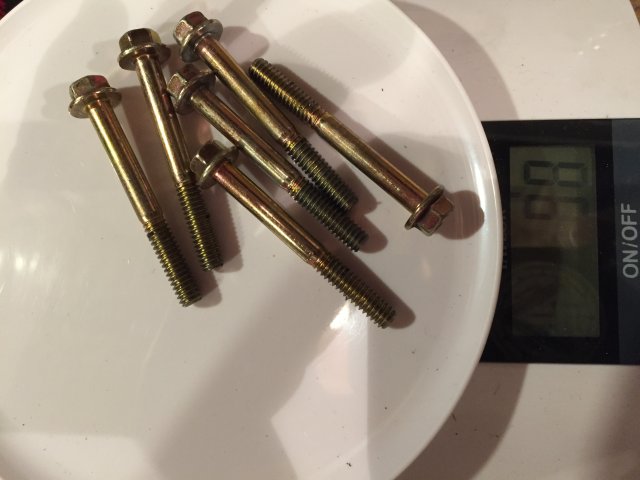

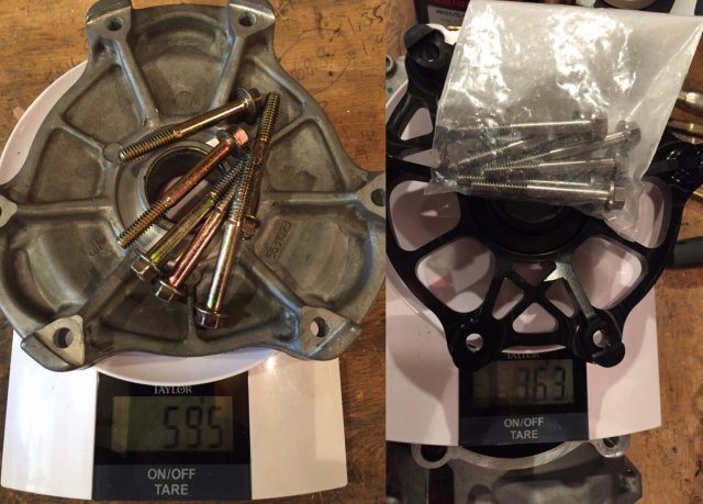

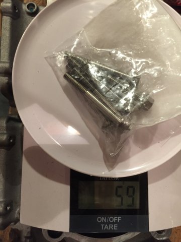

I seen those covers a few year's ago and wondered then about durability
Ya, thought I'd try them.
I carry extra clutches on trips anyways
What I like is that it take a Polaris bushing
Bolts are almost 40 grams lighter alone.
