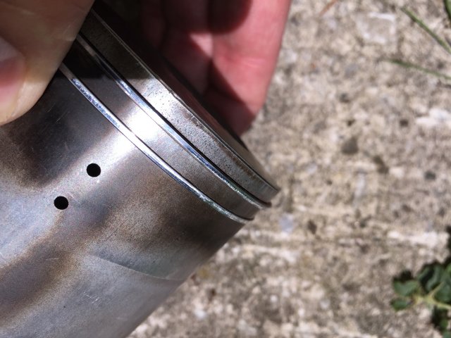

Not a big fan of the "shim and larger compression height pistons "vs Polaris. Did this in mine and won't do it again. Seen to many kits with shims and raised compression heights in pistons that have failed and half the life of stock Polaris know. I tried it twice and no more.

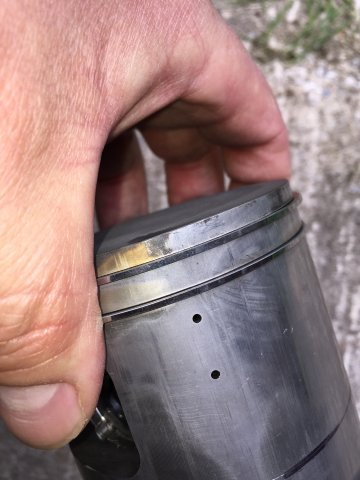

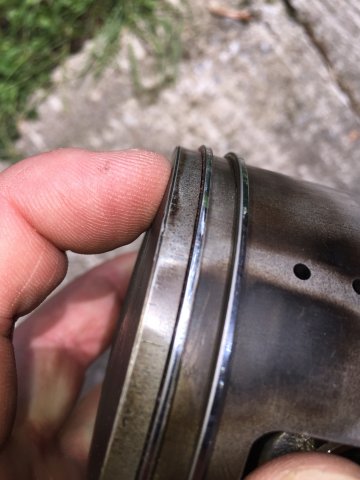

Cat and wossner pistons with shim. Two different sleds. 1800 miles on cat pistons with shim and has a sharp lip on exhaust side of piston due to bigger compression height(0.250"+/-) allowing pistons to slap in bore and push piston to exhaust side even though it had 0.005" clearance new . They are now collapsed 0.009"total .

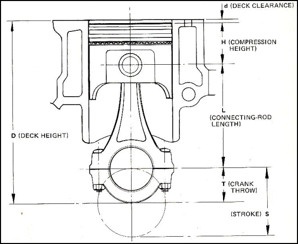

Compression height is from top of piston to center of pin and it's larger on cats vs Polaris. Polaris has the proper compression height.
Wossner durability kit pistons have 3300 miles and are collapsed 0.011-0.012" total
I don't like the compression height on cats or wossner 800 pistons and shim as this makes pistons rock in the bore even more then the stock Polaris pistons. The lower you put the pin on pistons, the more it will rock in bore

The thrust side is the intake side on any 2 stroke, the lip or edge you describe is a result of the piston trying to throw itself out the exhaust port, that's pretty common for that edge to form there.
Correct doc.
The lower pin placement on cat pistons vs Polaris forces the "piston to rock in bore" and puts "huge force on top exhaust side of piston trying to force it out exhaust port" resulting in a knife edge all the time. The wossner didn't knife edge as bad because of 0.020" offset of pin placement. Seen quite a few cat pistons with shim in the Polaris 800 motors now and the results are the same. It's basically a 1000 -1500 mile sled and change pistons. I did this and don't like the results seen and measurements after little miles on sleds. We all try stuff. Sometimes it works, sometimes it doesn't.
The proper compression height piston and 0.020" pin offset like Polaris doesn't do this . There is a reason Polaris has a shorter compression height and the proper pin placement.
I posted a general pic so everyone can see what is meant by "compression height"
The greater the compression height the more it will rock in the bore. The key is to have the smallest compression height(which Polaris has) but being 500 grams( which Polaris doesn't have) and tighter tolerances (which Polaris doesn't have). Polaris does have the correct pin placement but needs to tighten tolerances and taper and loose some weight to be the perfect piston in my mind.It's one of the better pistons Polaris has ever put out. But I would like to see what I mentioned above cause I'm very picky.
