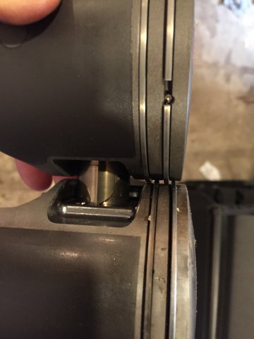

Axys 800 piston vs 2002 800 piston.
Just to show compression height changes over the years .
The smaller the compression height the better .
