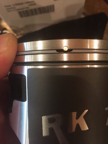

My opinion only here ,but, I think this type of ring end closure, the ring closure is asymertically on the axys of the ring and tends to roll or flex and the two or three sets that i have taken out because of scuffing in line with the closure (both on the piston and cylinder) supports my thoughts/opinions. I had built these Fix Kit engines myself and know that the ring end gap was correct and have since changed to the Polaris/Arctic type of ring closure over the grove centered pin. Years ago when I was building engines for racing , Free air cooled and liquid cooled later, I used a lot of Weisco pistons but then, they had an "L" shaped ring (great design) and a full over the pin closure. and I had great luck with those rings. Again, I am only passing along my most recent observations and results and I am sure that there could be other causes, but my opinion only!!

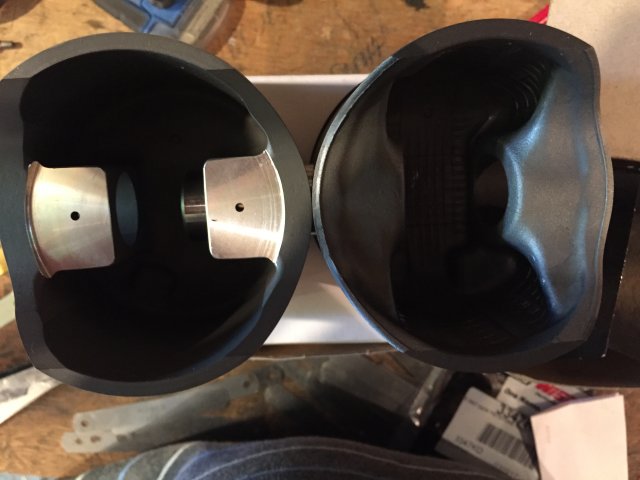

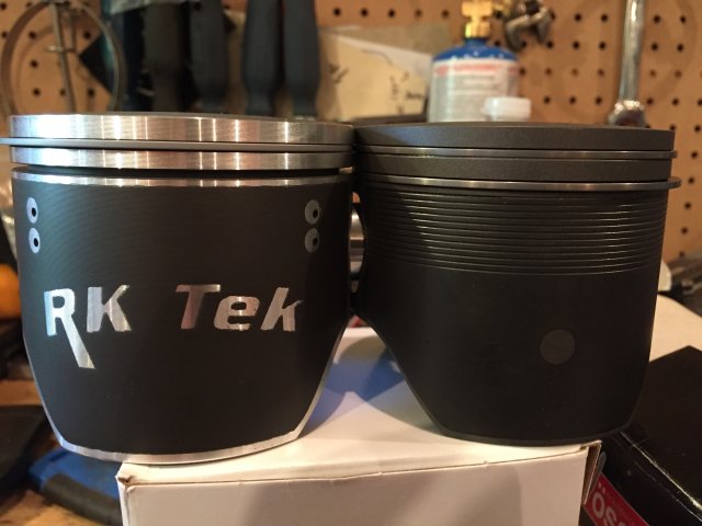

I see the rings are tapered thick outside to thiner inside like the cats, piston has less taper then the Polaris piston from bottom to top, shorter wrist pin, ring lands spaced different, etc .....

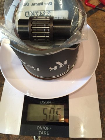

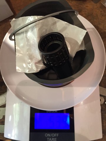

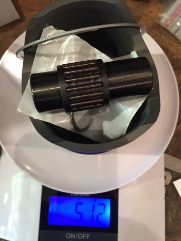

Rk tech piston all stock is 536 grams
With a titanium wrist pin that's about a 1/4" to long is 512 grams as you can see . Should be around 500 grams with proper length titanium wrist pin
Compression height is the same

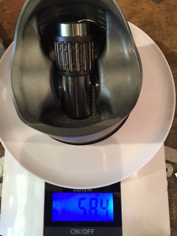

WOW 82 grams is a bunch!! What about the weight of just pistons as most of us would probably opt out of using the TI pins, although it is a great idea but $$ part might be the factor here. I assume the 584 g piston on the right is the AXYS?

Pistons were weighed with everything. The piston,rings,wrist pin, wrist pin bearing and clips.
Rk tech wiscoes are 536 grams
Polaris is 584 grams
The titanium wrist pins with DLC are 40% less weight then the steal stock pins plus the DLC resists wear and friction.
Ti-17 titanium is stronger then any steal.
To answer your question? Yes it will hold up. I tested them since 2001/02 ice and grass drag seasons. It was hugely expensive back then with dlc coating, wow!!
Anyways. I used a set of stock pins, pins of titanium with a steel outer shell pressed over titanium around 0.125" thick and pure Ti-17 with dlc . The steel had the regular heat (blueing) while the Ti-17 pins with dlc didn't have a mark. All you could see was an outline of were the wrist pin was. DLC coating is amazing .
Used it for trail riding after without any problems for 3200 miles before I sold sled .
Now I'm using it again as it's less expensive as 15+ years ago.
Honda and Ferrari started using Ti-17 with DLC back in the early 90's for connecting rods, valves, and wrist pins. It's stronger then steel and lighter. It's used for way more stuff too.
Check out Ti-17 titanium with dlc for yourself ?
Rk tek piston weight with titanium wrist pin with DLC coating . It's about 80 grams lighter then stock .Div20
