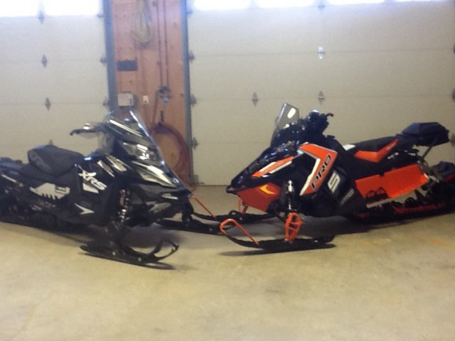

Can't wait to get ur sled dialed in and compare from ur doo

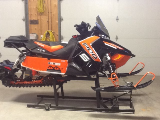

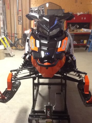

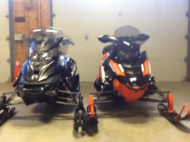

Pulled the tape measure out and Started comparing the 2 today.
It is crazy how similar they are by measurement.
Keeping in mind that I lowered my XRS by 1.5 " to same height as Renegade X.
Put the 18" windshield on my XRS so it would no look so different in the pic.
Biggest difference is the length Axys is 7" shorter from Ski tip to back bumper
Rest is pretty much the same.
Top of body height measures the same
Floor to handle bars same
Top of running board to bars same
Centre of skirts to rear axle same.
Seat height same
Axys engine seems to sit a bit lower 1/2" in the chassis
And the secondary position is way lower in the Axys
But when you sit on one then the other back to back the fit is different even if they measure the same.
The Axys seems to let you sit up closer to the front than the XRS
Being 6'-2" tall ,the Axys body looks like it will protect against the wind more
Really like the way the running board stays wider and kicks up at the end.
The Axys seems to be the better fit Without making any kind of adjustment .
Can't wait to make this sled fly!!Div20:JumpLetitsnow

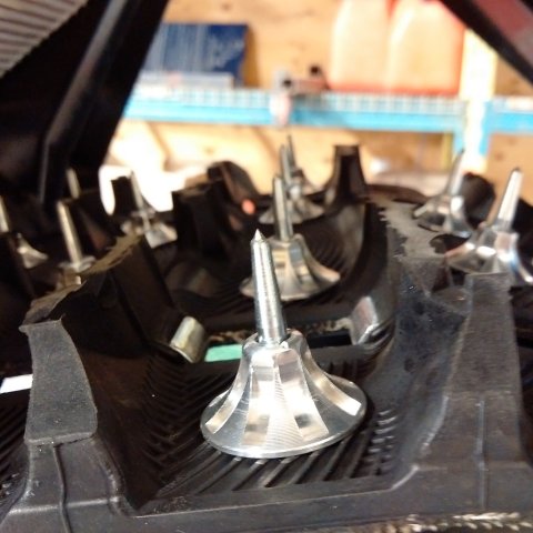

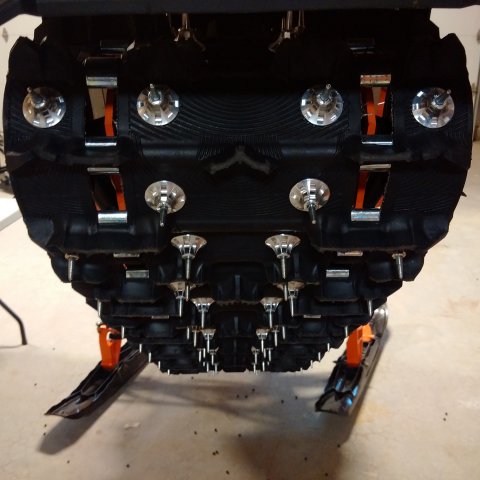

IMG_20151128_141447.jpg IMG_20151128_141458.jpg Studding complete 144 1.45 Woody's triggers 3/8 " above Lug should hook hard!!! Over 3.5 lbs of weight in the track with this combo over conventional washer and nut and Gold digger1.325
Can't wait to cross these road again!!!

View attachment 749 View attachment 750 Studding complete 144 1.45 Woody's triggers 3/8 " above Lug should hook hard!!! Over 3.5 lbs of weight in the track with this combo over conventional washer and nut and Gold digger1.325
Meant to say this set up is 3.5 lbs lighter than conventional aluminum nut ,washer and 1.325 Gold Digger stud
1.45 Trigger +STRS Backer =1.00 oz
1.325 Gold Digger aluminum Washer and round backer plate= 1.40 oz
Never used them. Just meant that they don't look durable for road crossings, concrete gas station drives etc. Lot of those where we ride in Wisconsin.
Have you had issues with the Triggers?
This is my First time using them and the STRS backers.
I figure I should be fine Majority of my Riding is Northern Quebec ,Cochrane and north of Huntsville.
I have run triggers and they last just fine if your easy on them when crossing roads, stud boy lake racers are a bit more durable ....
