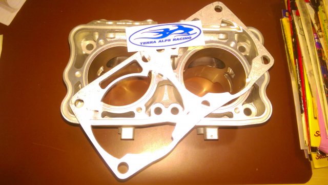

Brock, what pistons are you going with? Cat?

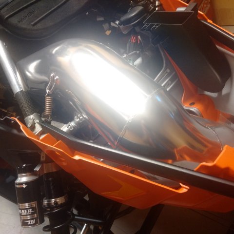

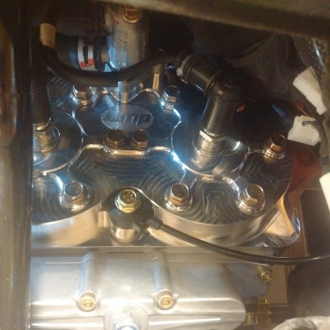

Bikeman Head & Pipe with PCV controller with safe Map 165 hp....
Made a Pull with a Greedy Map and Made168.8 hp still in breakin mode.

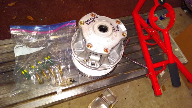

Your clutch is done. Everything checked.
Belt to sheave is 0.018" with gates.
Spider to tower clearance is 0.0015"
Machined a little for over drive(0.020").
Matched slp lightning weights (not rivet style)to 72 grams.( I love the profile of these weights, aggressive,but not drag race aggressive,and huge tip weight) . Load that motor!! Div20 140/300 spring, off to cv tech now to get balanced.

Clutch came back Balanced from CVTech, gears are in !!!!!!

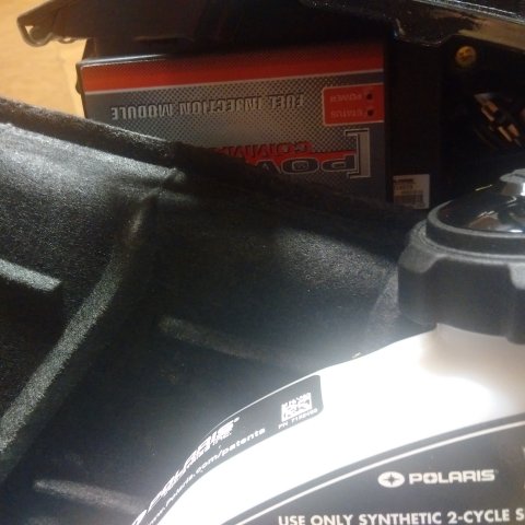

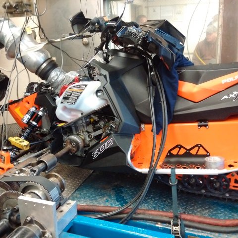

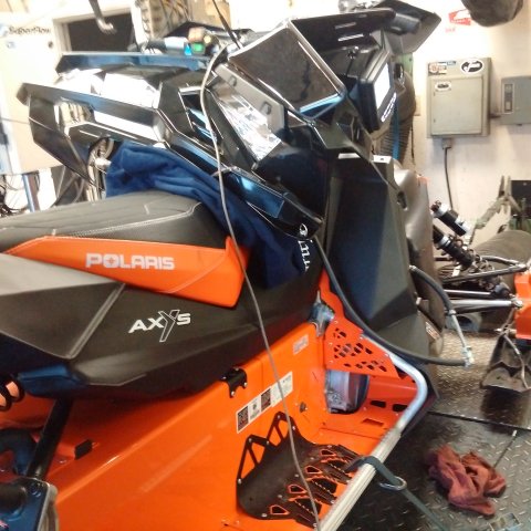

in all Honesty we were on the Dyno from 8 am with the 2 sleds till 9 pm. when it came time to do the test on the Bully dog controller we ran into a snag installing the program.
1st problem was that the Bully dog was not unlocked from Bully Dog themselves. after calling Joey at Bikeman he did a great job getting ahold of someone from Bully dog to get the code to unlock the unit. this was at 7 pm. it was only the second time they had this issue from bullydog. after resolving that problem the sled would still not take the program so we gave up on it and programmed a PCV controller and off we went.
in all fairness it was not a Bikeman issue . found out in days passing that my Dealer did not clear the oil Prime code at time of PDI so the ECM would not accept the Bullydog tune until the oil pump prime code was cleared. we thought it was the Tune that was causing the Prime code to come up. i will be bringing the bullydog and PCV back to DTR later this season to do post breakin and post season dyno results.
