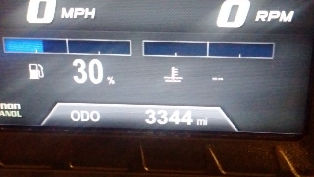

3400+ miles. Sure doesn't look like they have crossed many roads?
Oh we crossed many of roads and did some road bashing to get gas. Haulins studs are holding up well. My goldstars, not so much(junk)

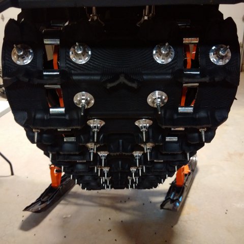

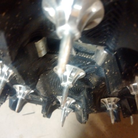

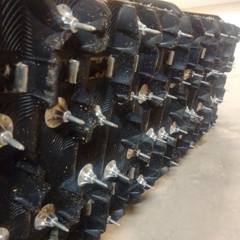

But are the picks above after installation or after those 3,400 miles? They don't look like they have touched anything, much less 3,400 miles in those pics.

Mine didn't wear well at all with 3300 miles.

They recommend part number PMM162LN if the stud length is over 1.4 inch. In the picture it looks like it's a three-quarter inch aluminum not they also recommend that for one ply tracks . Part number PMM137RN is for stud length of 1.40 and less. Those are dollar 99 each .

View attachment 749 View attachment 750 Studding complete 144 1.45 Woody's triggers 3/8 " above Lug should hook hard!!! Over 3.5 lbs of weight in the track with this combo over conventional washer and nut and Gold digger1.325
The weight savings here are compared as above stud and washer combinations . The strs backer really gives strong support but is pricy. But I think I would have a lot of bent studs to replace if I was not running them.
