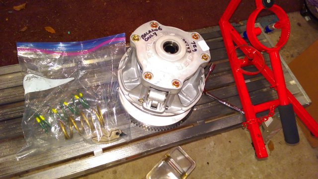

Your clutch is done. Everything checked.
Belt to sheave is 0.018" with gates.
Spider to tower clearance is 0.0015"
Machined a little for over drive(0.020").
Matched slp lightning weights (not rivet style)to 72 grams.( I love the profile of these weights, aggressive,but not drag race aggressive,and huge tip weight) . Load that motor!! Div20 140/300 spring, off to cv tech now to get balanced.
