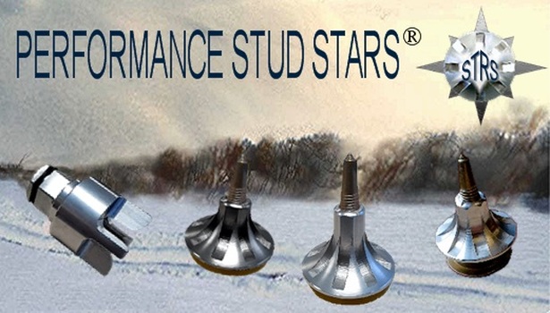

TRIGGERS ARE AWESOME! I ONLY HAVE 2 THAT ARE MILDLY BENT STILL SHARP WITH NICE TIP . I THINK THOSE STRS BACKERS REALLY HELPED ALSO LOTS OF SUPPORT FOR THE STUD. I HAVE 1.25 RIPSAW TRACK WITH 1.325 STUDS HOOKS HARD! I WILL ALWAYS INSTALL TRIGGERS FROM HERE ON IT. THE OTHER CARBIDE TIPPED PICKS AVAILABLE ARE TO BLUNT AND WEIGH MORE
what are strs backers?
just watching the weather let you know tomorrow somewhere out there Sagenew or river day lu and ride into Gaspe have a buddy that has been in that area let you know tomorrow
These, there very light weight and strong. If your doing 144 studs,these backers save you almost 3 lbs in rotating mass. Me and haulin weighed them with aluminum t nuts and backer plates to compare. There made in Ontario.
