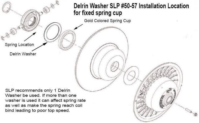

Where are you recommending Delrin's be placed in the Secondary?

I place my washer like derlin recommend. They say adding more then 1 can actually ca use binding from what I read. And my 1.74 gear sled pulls away from my sled 1.61 gear sled on the top end. The full shift out works.
1 2 or 3 Delrin's have been a ongoing debate for years. So has the binding claim.
