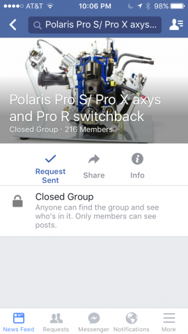

Polaris axys pros/x and pro r
It's a group
