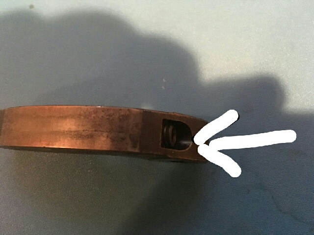

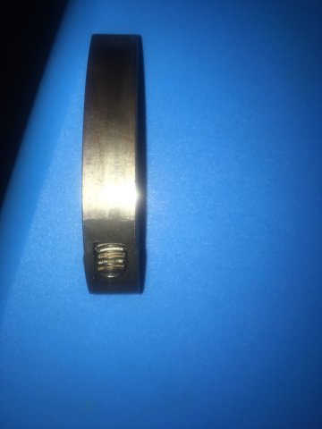

Dalton weights , bottom set screw . The one with the arrow needs set screw pulled out just like the other pictured. This gives you better belt pinch in hole shots .(more weight at heel)
You don't have to do it this way. That's what's nice about these weights .. you can set heel,mid and tip to what ever you want

What do you feel is the shortest set screw you can allow to hang out the back so you have enough threads so it doesn't fall out? You using blue Loctite on the set screws?
View attachment 1844 View attachment 1845
I am using the Dalton adjustable and i have the 1.3 on the heel and have two threads showing when i tried the 1.9 and 2.5 on the heel i had about three and a half treads showing with no Loctite and no issues
so far my best results in all different conditions 0.7 tip and 1.3 heel might be a good starting point for you to try
