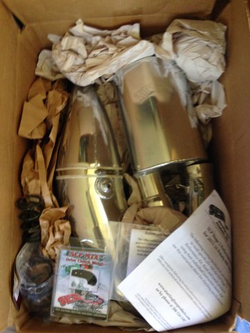

Did u already purchase the slp pipe set??
Yeah. See attached photo. I got a good deal on it pm if you want to know dealer name as SLP doesn't let them publish cheaper prices.
