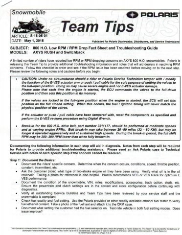

Does anybody know if Polaris addressed any of the 15 model problems for the 16 models?

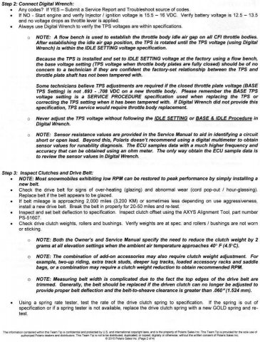

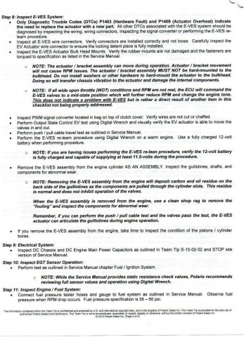

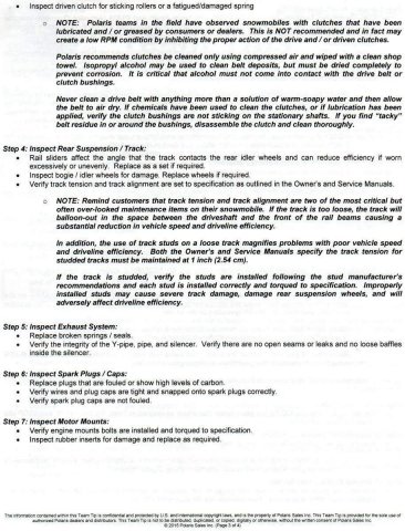

Yes, a bunch of new stuff. I posted it on here somewhere.
Belts are bad too. Getting fixed.
Inconsistent compound.
Just run a gate's belt.
Sorry Brock but I don't see the new stuff you mentioned. I seen the belt part of things and WOW! Not many people look at that. I sure don't or didn't now. Normally you buy a new belt for near 200 dollars it should be good. Thanks for all things info man now I will be able to see things better for the best performance.
I'm trying to help. Information I collected is based on findings from experience,testing,dyno testing,etc..
All things will have a few problems,as long as there is information out there to correct it. Then we all win.

Rail slider wear and efficiency....seems that the rear 4-6 inches wear quickly at first then wear slower. Just wondering how inefficient this is. I am considering Vespel sliders when I feel they need replacing. At 1850 miles they look fine for the most part.
