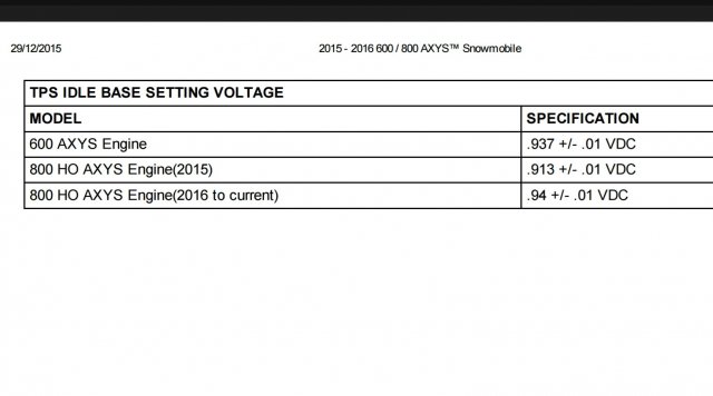

Info from a dealer.... 2016 TPS Idle voltage spec is different
BASE voltage is the Digital Wrench TPS voltage reading when the idle screw has been backed off, to allow the throttle plates to fully close.
IDLE voltage is the DW TPS voltage reading when the idle screw is in the correct position to hold the throttle plates partially open.
.... The IDLE voltage target specification is
. . . . . . for an AXYS 600 : 0.937 volts +- 0.01 vdc
.for a MY15 AXYS 800 HO: 0.913 volts +- 0.01 vdc
for MY16up AXYS 800 HO: 0.940 volts +- 0.01 vdc
It appears that some MY15 throttle bodies had the idle screw set improperly (mostly low) when they were flow tested, and then the TPS was set during production. It is also possible that with a little bit of vibration and running, the throttle plates closed up a little. (This would lower the idle speed, and the TPS idle voltage.) Polaris, may also have changed their spec. on what the target flow at idle actually should be.
It would be fair to say that the MY16 throttle bodies, will have more throttle opening at the idle stop, than the MY15s did. That alone would change the TPS voltage reading.
Polaris does not publish the target base voltage spec. probably because they do not want people trying to do it without Digital Wrench. When doing the base setting thru Digital Wrench, the screen shows what the desired base voltage is.
Someone with a MY16 doing a base setting procedure thru Digital Wrench, would see it on the screen.

The problem with the 2015 axys 800 was the throttle plates and the tps had to wide a range. I complained about this to polaris in February seeing different sleds on dyno while on digital wrench. This happened back in the Dragon year's with the range to wide. So they told us to set base voltage at .700 and what ever it is on top, leave it..
Well I told them anything over 4.38 @wot was bad. Every sled that worked good was way under 4.38@ wot.
My was to wide of parameters. I had to adjust throttle plates, synchroniz, set base idle around .700 vdc to get it to 4.34 @wot.
Mine was 4.39@wot. This adds fuel up top and does something to the ecu as it's sending a signal back it's to high a voltage. I got it to .703 @ base, 4.34@wot and set idle at .917.
It works better
The 2016 are a narrower range and higher voltage at idle.
The one we seen on dyno was .937@idle and 4.128@wot. Seems better. The parameters are narrower.

I had to adjust my throttle body plates to get my tps base voltage down. I was reading 4.39 volts @wot. My range was 3.637, so my base voltage was .753.
Just adjusting tps wouldn't do it.
I wanted to get base down near .700.
I got it set too .703 volts at base. By adjusting throttle body plates and synchronized them after. Then I set the idle at .917 and idled better and ran better with a better smooth sweep.
