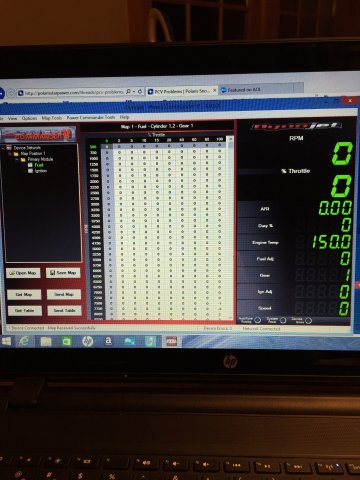

Installed pcv tonight and sled will not start. disconnected and sled starts. Should I be seeing throttle position on lap top when connected to pcv connected. Help
Grounded to where they say to with all factory grounds. Disconnected and reconnected and still no start. Pcv is showing that map is installed and I can read graph.
Removed from sled and checked all wires all ok. Think I got a bad one?
Anything look different.
Yup its the 032. Got another one in stock will try tonight. Let ya know. Thanks

Installed another PCV and still won't run. I guess a phone call to Dynojet is next step.
