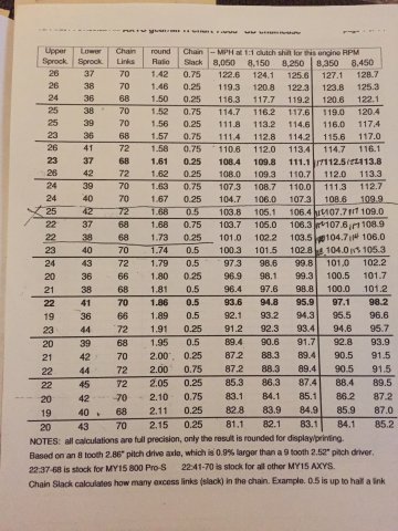

I was thinking about putting a bigger bottom gear 38-21 (i have 37-21 now) making a 1.80 ratio!. Curious what you guy’s have to say about it?!

Remember. The 2016 sb pro s800 has 2.86 pitch track and 8 tooth driver. Has the ripsaw which in my mind needs studs a 1/2” longer.
You want more top end??
With stock pipe it’s supposed to rev 8250 rpm at tops(no higher). So 8250 rpm at 1:1 ratio with a 1.73 gearing gives you 103.5 mph. An Overdrive if everything is set up properly, add maybe 5% to 103.5 mph which would give you 109 mph
Get a jaws, slp or bmp pipe and rev 8400 rpm we’re there supposed to and the 1.73 gearing is now 106 mph at 1:1 ratio.Add that same 5% overdrive and it’s 111 mph.
Personally. I would go with 1.68 gear ratio with stock pipe that revs 8250 rpm to give you 106 mph . Add 5% for overdrive and it’s 111 mph
If you add a pipe that’s supposed to rev 8400 rpm. I would go with the 1.73 gear ratio to give you 103.5 mph at 1:1 ratio. Add 5% for overdrive and it’s 111 mph .
You said you wanted more top end, so I gave you scenario’s to help. Just depends on stock pipe vs aftermarket pipes.
The 5% overdrive is general as you can get more with a machined primary in most cases
