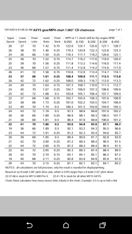

Hey doc n, or bigfuse or brock or anybody running 1.74, is the dogleg too much for aggressive riding? Have any of you broke a chain??
Dog leg isn't bad in the 1.74 ratio. Nothing to worry about..
It's just the 1.73 ratio has less dog leg.
I should have worded it like that. Sorry for confusion.
This chart shows the slack of chain in the column. It can be .25" to .75"
I always like the biggest sprocket on bottom you can get. But this center to center has a limited supply vs the pro r and dragon year's.
My favorite is the 1.71 ratio. But, it's not applicable.
Hope that helps
Don't worry about the 23-40 dogleg. Same amount of dogleg is on the Pro X and it is meant for harder ditch banging.
