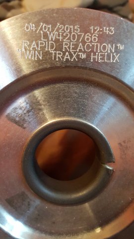

Can someone help clarify the EXACT model/ordering number Team 50/44 helix in need? I am confused on Team clutch type(s); Whether the particular 50/44 is for engine reverse--or not; and the 50/44 numbers--seem there is a several sets of numbers talked about when I search "Team 50/44 helix". Thanks.
JUST MAKE SURE OF TWO THINGS..1 ITS A FULL PROGRESSIVE CUT AND 2 ITS FOR ELECTRONIC REVERSE. IF VENOM IS CUTTING THESE HELIXES LIKE TEAM WAS THEN THE OTHER RAMP WILL BE 52-46 FULL.HOPE THIS HELPS.
When I last talked to Venom in early December they told me the 50-44f er helix should be available in early Jan. Roughly the 8th. Part number is
LW420766 and that is for electronic reverse.

As flasch shows his was made last April. The 48-44f I bought of Ebay was stamped July or August. I got it on Ebay from a place in Tennesse of all places. Maybe popular out there for ATV's? It was sold by Venom to a place called oemcycles
