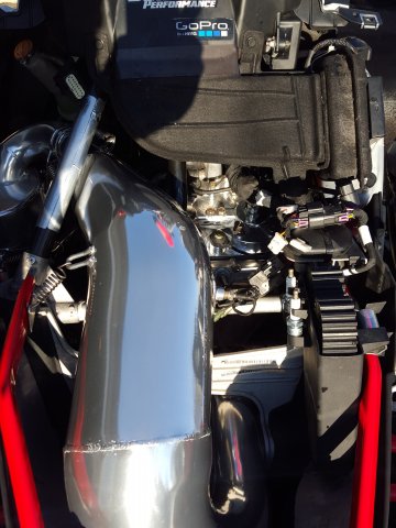

Ok, so here's the deal on doo2poo's axys on dyno...............
Bmp head,pistons,shim,pipe,muffler and bully dog stage 3 tune.
We also brought a Jaws pipe and pcv to test .
The whole bmp kit was broken in a little lighter and nicer on dyno cause of forged pistons. About 25+ dyno pulls before we started to put the coals to it hard.
The bmp whole kit seemed ok, but we weren't happy with bsfc's and afr readings being lean in areas with their tune. We piggy backed the tune with a pcv and made this motor a lot happier. The bsfc's and afr readings were way safer and we gained hp and torque by adding pcv on top of bullydog. Win win for doo2poo.
Now, a different test was holding wot on dyno for long periods to see if the jaws or bmp pipe made or lost. The jaws never lost any power held wide open for 30+ seconds, even as engine temp climbed to 150+. It made great power in the first 20 seconds at wide open, and still was climbing. Awesome pipe. The bmp was only tested for about 17 seconds and held for that period, we had to aboard test before we could go any further. But it held for that long too.
Now,to the good numbers part you guys all wanna see,lol
168 hp with bmp kit with jaws pipe held for 30+ seconds (pcv piggy back the bullydog)
171 hp with all bmp stuff held for 17+ seconds (pcv piggy back the bullydog)
This is a very happy and safe motor the the bsfc's and afr reading very good.
The jaws pipe can be held wide open for long periods of time and doesn't loose power, awesome pipe by Greg. Heath will agree with me on this I'm sure.
Awesome job once again!!

The jaws pipe is amazing!! You can hold this pipe wot for as long as you want and it doesn't lose power. Greg at jaws knows what he's doing. Kudos to Greg at jaws. We were all amazed at the long dyno pull at wot and never lost power. Was still gaining.
As for a straight number on jaws, about 6, but it doesn't lose at any point. With a little mod it's around 8 hp. It's very comparable.

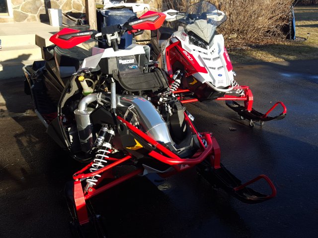

I ran my SLP stage 2 against Bikeman pipe, SSI pipe mod, in the field and they all ran about the same. The pipe mod guys are complaining about the det coming on.
I've ran my bikeman stage vs a slp pipe, head tunner and got him on the top end by 3 maybe, ran a ssi pipe and head sled and got that one by a 1 1/2 sleds up top. Idk my clutching is spot on tho vs those other sleds.
