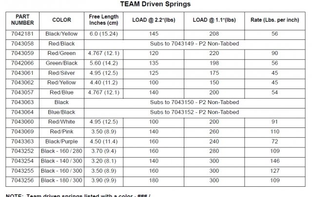

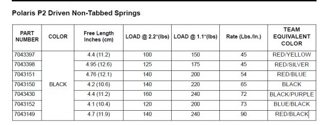

So now that I see there is a spring rate difference too. Can someone explain how these two springs act differently when compared to each other? The spring rate is the same but the lbs of load are different. 100-200 and the 140-240.
This can be expanded upon with both pro's and cons, but the first spring could let the sled shift out faster and give more topend, the second could let the sled backshift sooner and feel more respnsive IMO.
Both same rate yes. Start at different spring pressure as you can see.
Force lbs. @ 2.20”--1.10 of polaris team springs. To figure out the rate of a spring??
Eg. 140/200 200 - 140 = 60
Force lbs. 2.20 - 1.10 = 1.10
take the 60 from spring rate and divide by 1.10,which equals 54, 54 is the rate of the secondary spring above
The 140/200 has a spring rate of 54 and some may be similar but the 140 has a higher starting force.
Your 100/200
200
-100
100
2.20
-1.10
1.10
100
/1.10
90 spring rate
It's just the 100/200 has a lower spring force at the start then the 140/240
