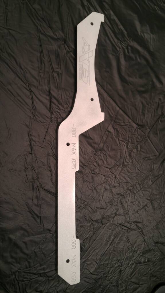

Proper clutch alignment
I received my alignment tool and it's nniiicccceeee
