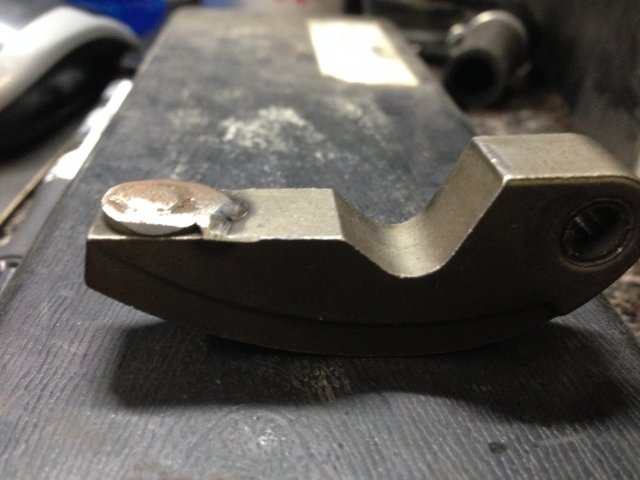

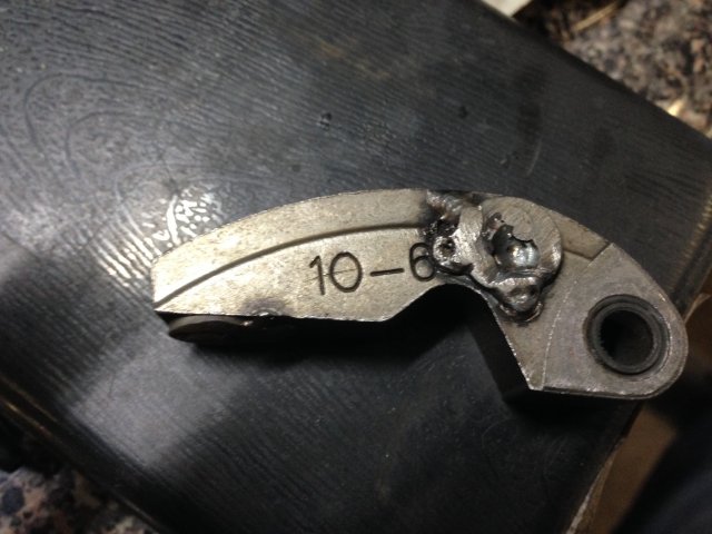

I understand what you are saying, and not being a smart azz to anyone else. Can you post a pic?
Welding weight's can be tricky. It's been many years since i did it on some old m weight's. They have to be cooled properly, and also not over heated.
Here they are

It doesn't have to look pretty bud. I've done that quite a few times too.
My welds are bubble gum,lol
