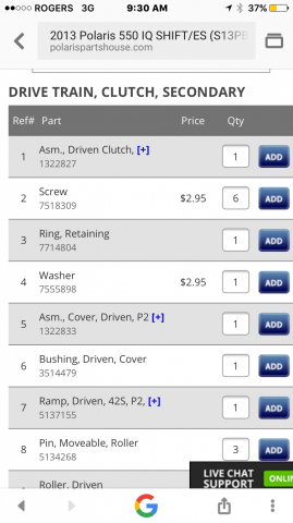

Take a look at a 2013 IQ550 Shift and let me know what you think? Not sure if the part #'s are any good but at least we got something to go off of. They are there and listed so? I'm sure I will be needing to figure this out in the future as I also like the P2 clutch!Not possible as bushings are not available.
You got all u need then?

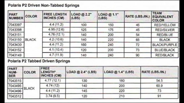

Just curious how recent that spring chart is? Years back I was interested in a few different tabbed springs for the P2, I think they may have been all softer than whats listed, but I do have the 140-200 which I ran in my FST, and of course the 130-180 that most sleds com with. Years ago there were a lot of the springs that were not available.
